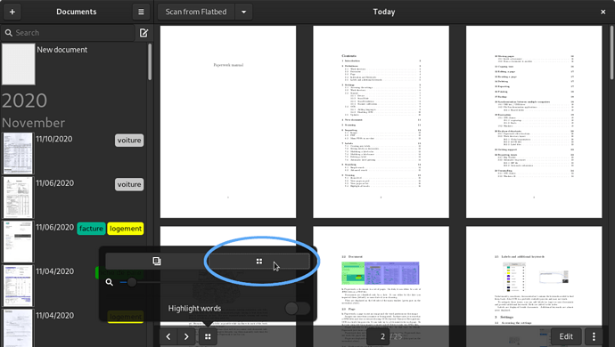

It is possible. You can drag-n-drop pages to other documents, including to the fake document “New document”. Droping a page on “New document” will create a new document.
Just make sure you’re in grid layout. Otherwise it will select text in the page instead of moving the page.
